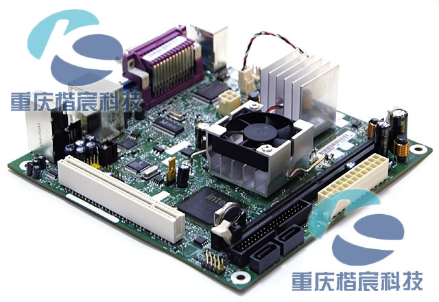

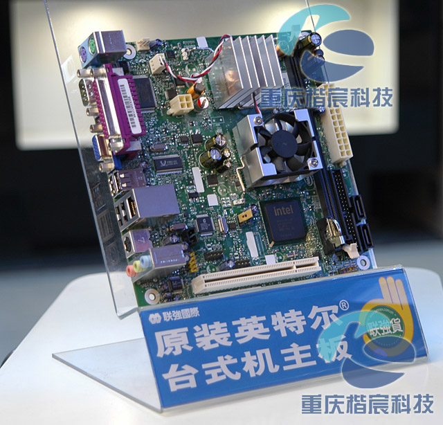

双核Atom主板隆重登场,主板型号为D945GCLF2,仅仅比单核版本多了一个“2”
主板全貌

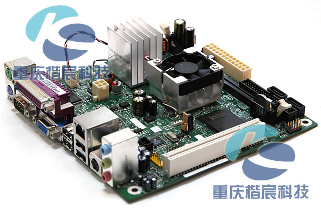

继续主板全貌

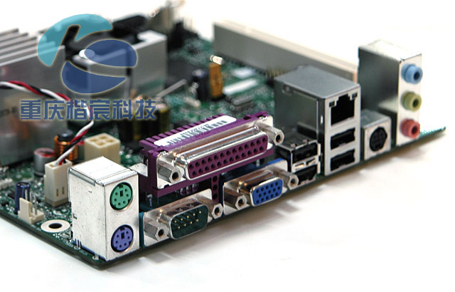

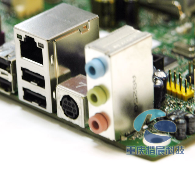

主板接口,和D945GCLF差不多,但是多了TV-Out,不过我估计这个接口也属于选配
TV-Out接口特写,貌似有支持色差的可能

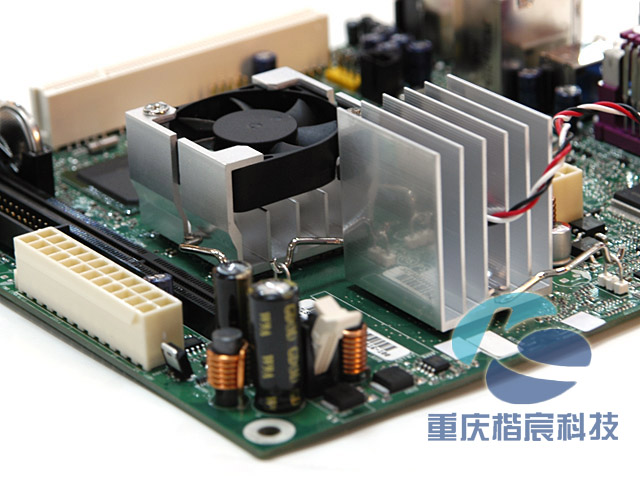

北桥散热器高度明显降低了,但是CPU散热器也太山寨了吧,不知道Intel在搞啥

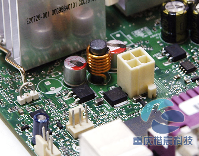

供电模块的特写,改双核了,所以有点变化

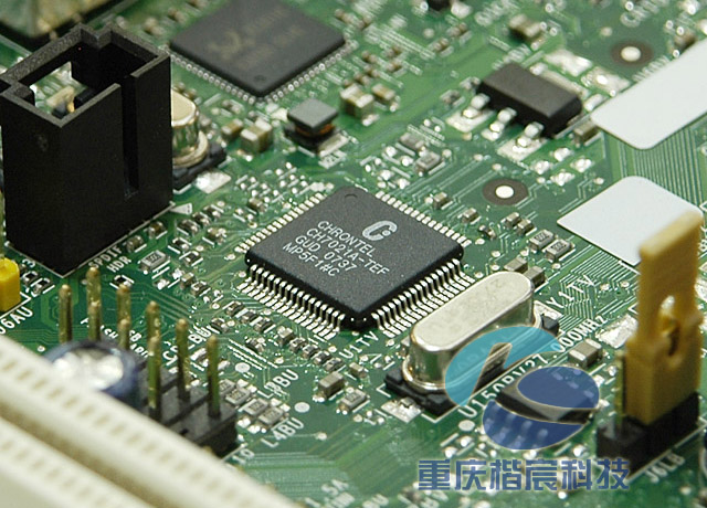

CHRONTEL CH7021 SDTV/HDTV编码芯片,主要功能如下
VGA to SDTV/EDTV/HDTV conversion supporting graphics resolutions up to 1600x1200
HDTV support for 480p, 576p, 720p, 1080i and 1080p
Support for NTSC, PAL, SECAM color modulation.
Macrovision™ 7.1.L1 copy protection support for SDTV (CH7021 only)
Macrovision™ copy protection support for progressive scan TV (480p, 576p)
CGMS-A support for SDTV and HDTV
High-speed SDVO* (1G~2Gbps) AC-coupled serial differential RGB inputs
Flexible true scale rendering engine supports overscan compensation in all SDTV/EDTV and HDTV output resolutions
Text enhancement filter in scan conversion
Adaptive de-flicker filter with up to 7 lines of filtering in scan conversion¥
Contrast/Brightness/Sharpness control for TV output.
Hue/Saturation Control for TV output.
Support for SCART connector
Support for HDTV D-Connector
Outputs CVBS, S-Video, RGB and YPbPr
Support for VGA RGB bypass
TV / Monitor connection detect
Programmable power management
Four 10-bit video DAC outputs
Three sets of DAC outputs supporting SDTV / HDTV / CRT RGB connectors
Fully programmable through serial port
Configuration through Intel® SDVO OpCode*
Complete Windows driver support

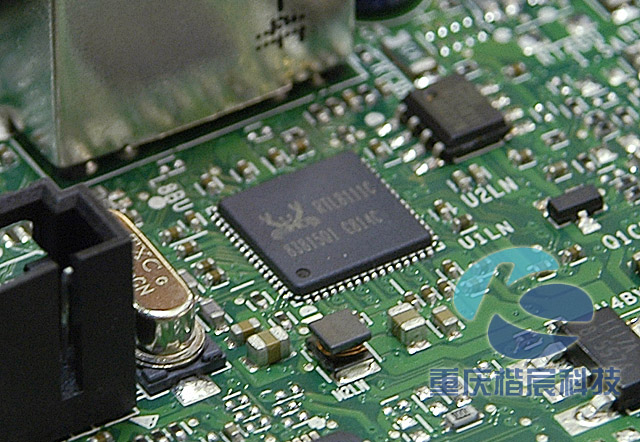

Realtek 8111C,终于升级到千兆了

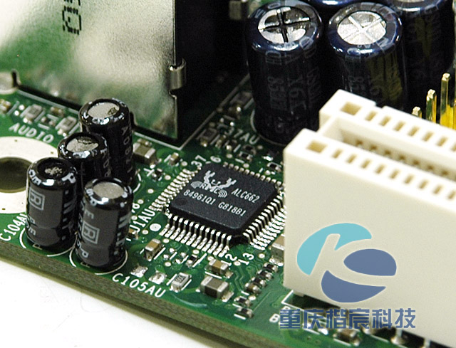

ALC662,5.1 声道High Definition Audio Codec

Outputs CVBS, S-Video, RGB and YPbPr,的确支持色差
貌似有hdmi?
还是六声道声卡.
没那个风扇 就好多了
就看风扇不爽
那个支持高清的芯片有啥用?你拿VGA或S-VIDEO还是色差接平板电视???声卡也有问题,所以暂时做高清机还是有点困难。办个公或者当个下载机而已……

1.6GHz双核Atom放1080p估计还是困难,不过720p足够了。另外,液晶的动态清晰度有720线就不错了。
那个芯片的意义在于提高了连接的兼容性,因为有的电视机VGA接口兼容性并不好,如果是720p或者1080i色差信号,就不存在兼容性问题。至于S-Video,清晰度太低,完全无视。
